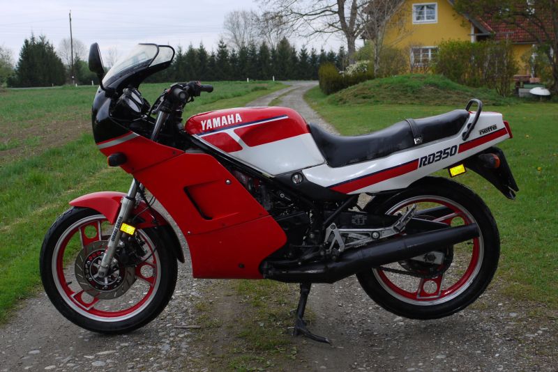

On the Road...RD350 31K Long Rod 4mm and some more...
On the Road...RD 250 4L1
On the Road...NS400R
On the Road...TDR250
RD 350 LC in der Kiste
