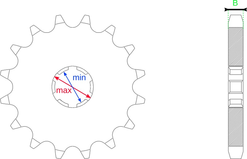

Ritzel:<br />4Lx: ID=21,4/25mm, grobverzahnt, B=9,525 mm = 3/8&amp;quot; (530)
Ritzel:
4Lx: ID=21,4/25mm, grobverzahnt, B=9,525 mm = 3/8&quot; (530)

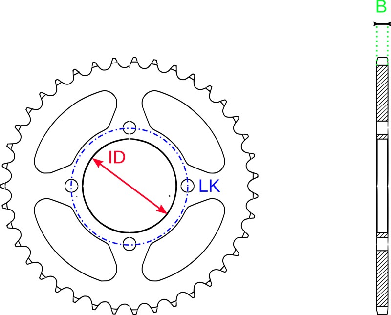

Kettenrad:<br />4L0: ID=74mm, LK=92mm, B=9,525 mm = 3/8&amp;quot; (530)<br />4L1: ID=74mm, LK=110mm, B=9,525 mm = 3/8&amp;quot; (530)
Kettenrad:
4L0: ID=74mm, LK=92mm, B=9,525 mm = 3/8&quot; (530)
4L1: ID=74mm, LK=110mm, B=9,525 mm = 3/8&quot; (530)
