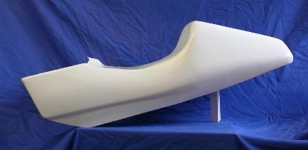

Can anybody tell me which model cast wheels ,three spoke , would fit on my LC , and a set of upside downs wouldnt be a bad idea . Has anybody got a seat from the UK firm "Ragged Edge Racing" It looks[font=Arial][/font] great .
